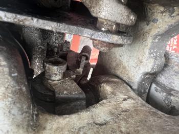

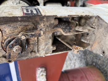

* Thanks for the help.
The fix was really simple - no new cable needed.
There’s a spring loaded lever on the right side of the leg towards the transom. This was completely seized with marine gunk…. a flat bladed screwdriver, a few light hammer taps and copious wd40.

* Hello fellow Hardy fans,
First a small apology - I'm not the most practically minded skipper!
Our 1986 Hardy 25 is in generally fine fettle. We seem to have a recurring issue trying to engage reverse gear - the control lever cannot be moved into reverse position at all and we seem also to have developed what feels like a 'false' neutral position where the lever is still angled forward. All a bit disconcerting on our last river trip out with the grandkids on board, fortunately a gentle glide against the river flow got us back onto our mooring safely.
A few years back someone in our marina 'fixed' the issue in a couple of minutes by removing some 'gunk' around the various linkages in the leg itself - I wasn't watching at the time, so not sure what he did. We did however go on to replace the control lever with a new Volvo part.
First pic below - forward gear engaged. Second - neutral engaged.
Guessing that I may now need to replace the shift cable. Would anyone (Simon?) happen to know the length I need?
