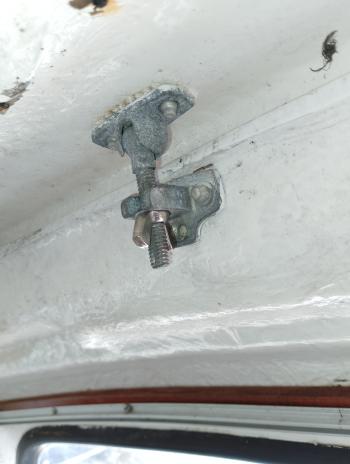

Hi Peter, have to say never tried gaining access through the hatch to the foredeck, you must be fairly agile! (Lol!)
If I was looking to do what you are, I would look at either making something like this, or purchasing something suitable which could be super glued to the hatch alongside the threaded rod, this would be used to secure the catch rod temporarily to prevent it falling and re-engaging, or remove the large nut from the rod and place it somewhere in the cabin for safety. (things put in pockets can be lost overboard)

They are the rubber stays fitted to cars to park/secure the bonnet stay, you can pick these up from auto dismantlers but I wouldn't think it that difficult to make one with a piece of rubber, that would be my preference!

Yes I'll probably stick with the same design in the end. One of my main gripes is the fact that if you open the catch when down below, open the hatch and then close it when on the foredeck (to stop the rain getting in) the catch can partially re-engage and prevent re-opening without going down below again. I use the hatch as my access to the foredeck while at sea to avoid using the side decks, so it's important to me that I can open it from the top.
I will have to devise a simple clip to hold the fastener up out of harm's way if I can't come up with anything else.

I think you'll find they're called "Brighton Fasteners". A search may come up with differing types that may be more suitable.

I note on yours that someone has fitted a non standard wing nut in place of the correct retainer piece, it was this part that was missing on our boat. You can also purchase this catch in solid brass finish which is the one I bought for ours, in my opinion looks a little bit better than the standard finish.

Part of the hatch lock was missing on our MS 18 when it arrived at Amble last year, these are a simple casement window sash lock and can be obtained just about anywhere, they are fairly cheap and easy to replace, just drill the old pop rivets out and refix the new one with either pop rivets or small suitable machine screws and lock nuts.
https://www.ebay.co.uk/itm/334175431617?itmmeta=01J30T71TW8HMGYGSFVKDQFYT0&hash=item4dce686bc1:g:M4AAAOSw58lhYYhn&itmprp=enc%3AAQAJAAAA4BWHZJ5Ovp%2Bzh6c3z6LdE6XO8OfbXDls5GeFT6B5lw0onP5Ub%2FjenKFS9mH9OQ2fegMsXNNrmh2gYrTo9vDhjHXUk2yDsN3oZ8TRUO7u3TvkVkQTR0K5BjhuHf82cDu%2BdoBqEqfE6BZqHkEWzrgMs1K%2B6mXUw63dShnIoGLaM0XmWjwzZLfIoRqDuKVoNQTccaEamtHbK5wP8DO9mRqyeo8uuqh2Wbh2bcVR7cAx8Ur4UhyaxPwU8HiXSBpTQAfMoAIKvpF2W%2F2BfnB0p2i%2B3lIKJ%2FrEvjDeNn%2BAeqSrM1Kh%7Ctkp%3ABk9SR8KdnJqYZA
Your local hardware store may even have them, they are fairly common!

* Hi all,
I need a new lock/fastener/catch for the front hatch on my Navigator. The existing one is well corroded (see pic), and has never been very user friendly. Very fiddly to fasten and catches when you don't want it to. However, I'm having a deal of difficulty finding a suitable replacement. Can't see anything online or on Ebay that fits the bill.
I've been looking at various combinations of bolts, hasps etc, but can't come up with anything that is simple to install and operate.
Has anyone replaced their's, and if so with what?
