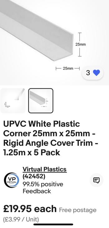

Hi all, I’m not sure having anything other than an original rope support would devalue a boat- not like when restoring a classic car to original spec.
Boats always get upgraded over their lifetime, from fittings, to electronics, engines etc.
We did consider the stainless steel and anodised aluminum route but these have no flex and if ‘bumped’ might cause more damage to the hull.
So, the uPVC is not a plastic and as such won’t go brittle or suffer with uv degredation for many many years- after all, these are used in home windows and doors for many years.

I don't think the pvc angle will work for various reasons, fitting a straight 90 degree angle to a curved hull, will inevitably result in the distortion of the plastic and stressing of the corner, over time, that could result in failure.
The suggestion of a firm knocking up some plastic equivalents of the wood supports isn't likely an option as the plastic resin wood composites usually only come in 'standard sizes' and anything outside that is unlikely and would be costly. The type I have used in the past has a wood grain affect finish and once cut, this is lost and the composite structure revealed. It could be that a suitable sized piece could be cut at an angle to replicate the shape of the originals, then the cut side could be fitted to the hull leaving the wood grain effect on the outsides.
Normally the original supports are fixed through the hull from the inside of the hull into the supports. My experience of the composite materials is that this type of fixing would/could fail over time and it would be better to 'fix through' the hull and support with suitable stainless fixings.
The wood/resin composites can be obtained in many colours including white but my preference would be the teak colour, (correctly done, it would look identical to original from a distance) in cold temperatures they can be brittle and will shatter if dropped on a hard surface, normal wood has a fibrous/cellular composition and wouldn't do this, don't ask me how I know that!

Can you find a plastic firm that will knock you up a replica few lengths of moulding, plastic right angle good way to devaluing boat. Also not sure how that plastic trim is going to stand up to UV in a few years

We were considering a upvc angle.
We’ve got a white hull so can use white but there are other colours available.
We just don’t want to be doing this job again in a few years.
Apologies to any purists ????
