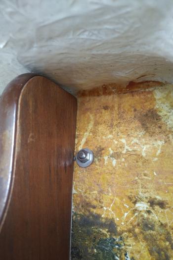

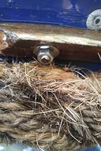

And:
Message 12 of 13
Posted by member Peter Clubbe on Friday 15 March 2024
Well I finally got round to refixing the wooden rail, turned out to be easier than expected, Simply drilled throughj the rail and the hull with a longish 6mm bit, having trimmed off the old screws with a Dremel, and used a length of 6mm A4 with a hex nut and biggish washer on each end to pull it back into place. Only a temporary fix really as I've found some rather soft areas of the rail (where all the water drips off the side deck in particular), and the rope itself is a bit iffy here and there, so it won't be too long before it will all have to be replaced. Interesting to see a new thread has been posted about replacing the wood with plastic. Certainly a possibility provided that the plastic is roofing/cladding grade to resist the UV.

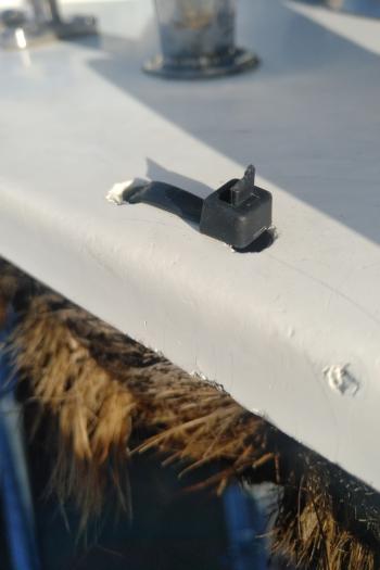

The problem with the plastic cable ties is you will be lucky to get a couple of seasons out of them before they go brittle and snap - easy and cheap enough to replace though!

On a separate (but related) problem, has anyone come up with a better alternative to cable ties for holding the forward end of the fender up to the gunwale? I replaced all mine last year and they've almost all failed due to UV degredation.
