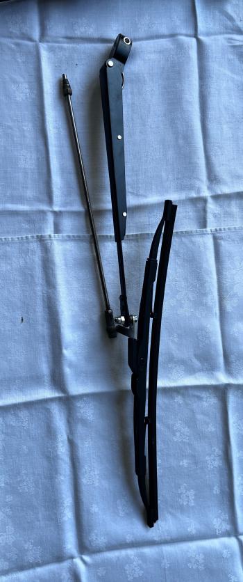

And one more of the completed assembly

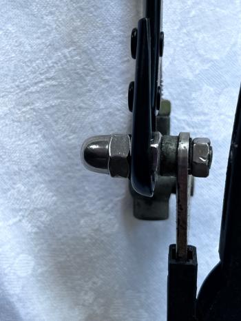

Posted by member Ruth Tracey on Tuesday 30 May 2023
Here's a photo of the bolt assembly attaching the original rod to the new wiper arm.

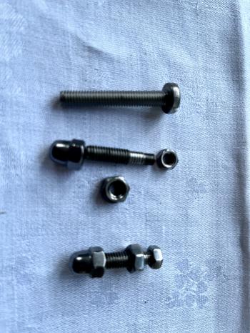

Many thanks to both of you! My brilliant engineer husband (another Peter) has been beavering away. He cut off the old very corroded arms and bought 3 new ones from ASAP. The hook at the bottom was removed and the hinged rod attached with an arrangement of bolt and nuts which involved removing the head and reducing the diameter in two steps which he did on his lathe. I attach a photo of the bolt before and after. The prototype worked well so another two are on their way.
I'll post a couple of other photos of the process separately - it seems that you can only post one photo at a time.
