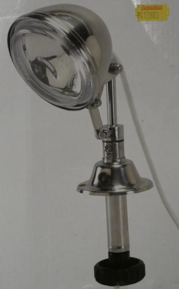

Thanks for your thoughts Tony. I've been on a short break but pondering on the problem all the while. Unfortunately i can't get good access to the base plate as it's fitted between a handrail and a slope in the cabin roof. This rules out angle grinders.
So two options I think:
1. Turn the bolt heads from above while the first mate hold a finger over the most likely location to detect movement in the headlining. Then use a needle to identify the exact location, perform micro surgery on the headlining and remove the nuts with a socket. Fit new searchlight disguising the fitting by using domed nuts to make them a feature thus hiding them in plain sight.
2. Other option is to leave the base and tube in place, buy a modern LED light with a central fixing and install it reusing the original tube. With a bit a adaptation it could give left/right movement but nothing up/down. Unfortunately the power cable comes up through the base so it would require an external waterproof join of the new and old cables.
I haven't got a photo of the fitting but I hope I'm attaching a photo from the box.

Bit of a problem Terry.
If you intend to remove the lamp I guess you would have been left with screw holes in the roof, anyway. I'd be inclined to leave the headlining alone. Could you cut the heads off the bolts and leave them as studs to fit either a replacement lamp or a thin s/steel blanking plate or an adaptor plate with hardware fitted to suit new lamp hole positions? If the old bolts could be used as studs then a screwdriver slot cut in would stop them turning until tight on plate.
Just a few thoughts, maybe a photo would prompt a better solution from other members....all the best in Tony
