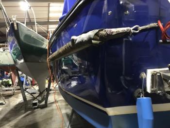

Posted by member Kenny Clark on Sunday 7 June 2020
Loads of products on the market for restoring shine to blue gelcoat. I have been using same products for last 10 seasons, which has served me well.
Meguiars Ulitmate Compound.
Farecla UV wax.
Silverline machine polisher, foam pads and wool polish pad all helped.
