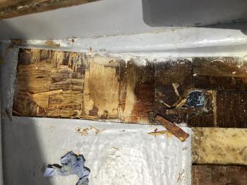

Posted by member jim harwood on Sunday 11 February 2018
Old section removed boats out for a while so no rush to get done happy I have got time to fix and will make sure it’s well reinforced.

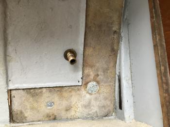

Old section not looking too good

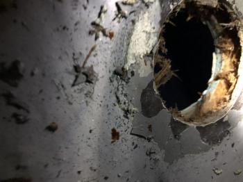

Posted by member Simon Kidd on Sunday 11 February 2018
Hi Jim.
Pretty much as you said - carefully cut back internally to expose the rotted and wet ply - it may or may not extend far. Replace with new marine ply and overlaminate - however, the Plywood grid is structural - it's used to stiffen the hull (needed due to the "Spray Layup" moulding technique), and this part of the hull takes a real beating when running fast at sea, so a strong repair is essential - especially if the rotted area is large. I'd suggest that once the new ply in laminated in, the area, at the very least is heavily re-laminated over a wide area using some woven rovings and chopped mat - probably four layers minimum. It's important the stiffened area is wide - i.e well past the rotted plywood, to ease the loads on the butt joints between old and new plywood. It is also essential that the once the old material is cut back the whole area, including the existing plywood is dry, otherwise, the resin will not adhere well. Due to the area being strength critical, the use of marine grade epoxy for the repair would be preferable.
The above might seem overkill, but best to be on the safe side.
It does have to be said - that is the original fitter put the through hulls just through the FRP skin (i..e a few inches away from their current location, then this wouldn't be a problem - always best to leave cored laminates sealed and undisturbed. It might be worth checking the intake through hull for the same problem.
I hope the above helps, If in doubt, give me a call, details in front of Magazine.

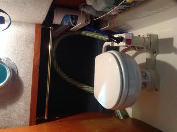

Posted by member Kenny Clark on Sunday 11 February 2018
Godfrey,
Photo of sea toilet installation for your information. Note waste pipe length - this acts as 'U' bend.

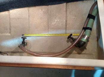

Godfrey,
Photo attached of sea toilet thru' hull plumbing installation on HP 20.
Photo - taken looking down at starboard seating locker.
Waste pipe 45mm O/D. Gate valve 47mm dia (threaded part thru hull).
Water intake pipe - 25mm O/D. Gate valve 25mm dia (threaded part thru hull).
Dimensions from inside face of locker from right (toilet panel) to left:
190mm to centre of waste.
500mm centre to centre waste/water intake. Should be able to make this out on tape measure.
Dimensions up from locker side going starboard:
Waste pipe centre 230mm.
Water intake centre 190mm.
I beleive ball valves are the way to go rather than using old school gates valves.

Posted by member jim harwood on Thursday 8 February 2018
Just removed hull skin fitting from sea toilet now that we’re out of the water as had noticed the hull flexing.
Lots of rotten wet wood due to it not being sealed correctly by whoever fitted it. Any ideas on best repair. I’m thinking of cutting back the internal skin to expose the wood that’s wet to dig it out and replace with marine ply then glass back in.
