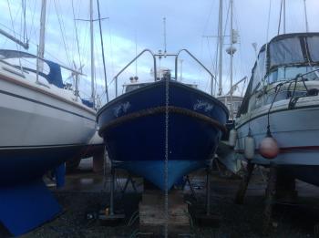

Martin,
Can't help with boat stands I'm afraid. I find best way is sleeper blocks to take full weight and legs to steady hull.
Small, medium and large legs are normal. Small legs usually 600mm - 900mm, which should be suitable for Pilot. You can alway sit legs on blocks if required, if a bit on short side.
Have also used logs/wedges only at midships, as need proper support legs at transom.
Photo attached. Good luck.
