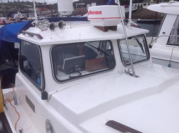

Windows infills before fitting new. Photo attached.

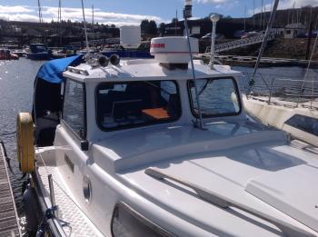

My windows looks nearly new. Just replaced the white infill strips to existing window seals. Photo attached.
Got infills from sealsdirect.co.uk Remember to order fitting tool. Old infills were dull and faded. Pretty easy to fit once you get the hang of it. Using plenty of soapy water makes fitting much easier.
