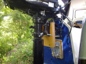

Ian, Clives comments above are very valid. I would strongly suggest "offering up" the engine and bracket to check the fit with the engine fully tilted etc. On Hauley, I ended up fitting a larger pad on the bracket to essentially "push" the bracket a few inches astern and up (because i didn't do this testing before fitting the bracket), thus allowing the outboard to clear the transom when fully tilted, and allow the lower unit of the longshaft Yamaha 6hp Fourstroke to clear the water when underway. I used a Yamaha Screw clamp lock kit which just fitted.
I have attached a photo that should just about show the installation on Hauley.
