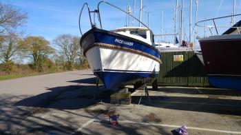

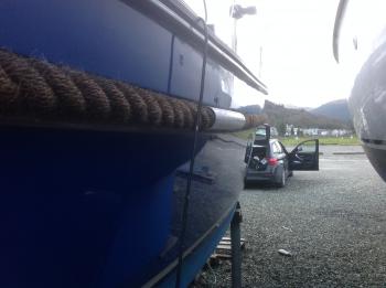

Posted by member Kenny Clark on Monday 6 March 2017
Spring cleaning today at marina. Quite pleased with results:
1. Farecla Deep Clean Wash.
2. Meguiars compound applied with elec. polishing sponge.
3. Clean off all compound.
4. Elec. polisher.
5. Apply Farecla Profile UV wax. Let dry, hand polish.
6. Light elec. buff to good shine.
Antifouling with Cruiser Uno next, then Happy days.
