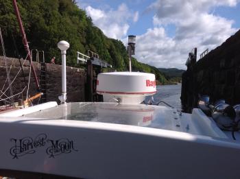

Kenny,
Thanks for your prompt reply, as I have bifold doors across the back of the wheelhouse I will keep the opening hatch but cut a square out of the hatch and fix acrylic to it. That's a good tip re edging the acrylic I will give it a go this summer.
Steve.

Steve,
No problem. I was not bothered about an opening hatch. Screw fixed 6mm clear acrylic sheet over opening. Used blow torch to heat/polish edges to a finish, rather than saw cut.
Still looks pretty good after five seasons. Planning to replace in 2017 as some cracking at screw holes. Better to machine bore screw holes on flat surface, as hand drilling can cause bit to bite into acrylic and chip.

Hi Kenny,
Reading the comments on winter storage and looking at your last photo I notice that you have a clear hatch cover, I have just purchased a Regatta that has a solid fibreglass hatch cover over the wheelhouse and have been. Wondering what to do, your hatch cover looks like the answer, How have you found it to be and have you had any problems with it ?
Steve.
I apologise for hijacking the thread but when I saw the hatch I had to enquire.

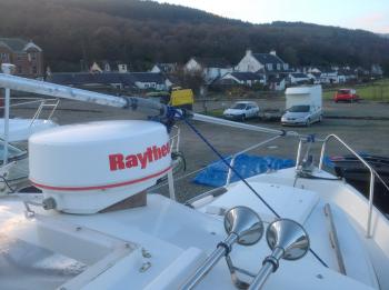

Hi Kenny
That's brilliant, great idea!! Nice radar and double horn too!

Simon,
New use for decorators pole.

Simon,
Thanks for your advice. Decided to use decorators extension pole, running fore & aft From wheelhouse to bow handrail, before using tarps.
Seems to work.
