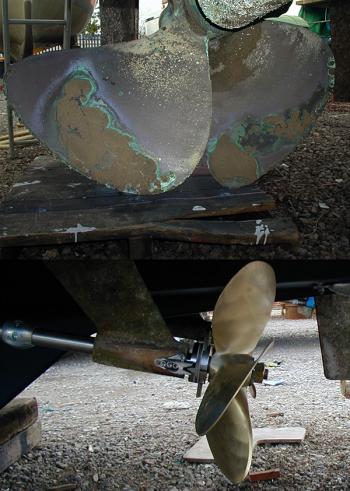

I see genuine cases of corroson to stern gear monthly - if not weekly, noramlly in the form of prop de-zincification (Manganese bronze is the common material - and really this is closer to brass, not bronze - so protection of the shafts and props is important in my opinion. Good protection is normally afforded by fittiing good quality shaft brushes within the engine / stern gear compartment, wired with high quality wire and fittings to the hull anodes. As low electrcial resistance is the key. I'm not a beleiver of Anodes only working when they can "see" sterngear etc, but a very good low resistance connection is essential. I normally check resistance with a simple muti meter as a basic check on the lowerest resistance scale with will often fine 0 ohms (now, there is clearly resistance, but low enough). I tend to see corrosion either where there are no anodes (far too common) or where there are at least a few ohns resistance in the cathodic circuit.
It should be noted that I only ever get to se the visible corroion, i,e unless the prop is removed, I'll not get to see if crevice corrosion is present on teh shaft, though I do hear of this (also in stern glands etc). In terms of materials - Austinetic Stainless steel has been in use for many years - though a few cheaper types are out these - I'd think it unlikley Hardy fitted this stuff.
Bare one last thing in mind, in some cases - I'll see corroion creeping in even with a good cathodic protection system - noramly due to an DC leak (poor bilge pump wiring etc) or AC - fault charger or immersion heater being the most common - so even a perfect system doesn't solve all issues. So - perhaps - if removing the shaft anodes, fit larger or additional hull anodes?
