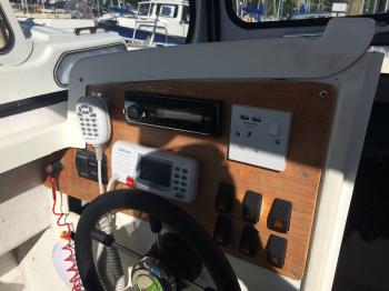

Posted by member craig allan on Thursday 11 August 2016
photo update 3
Message 24 of 26
photo update 2
Message 23 of 26
photo update 1

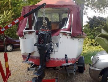

hey guys been off for a while been absolutely manic with work lots of people with engine problems and a few with structural hull problems :O

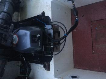

ive decided to remove the 6hp Yamaha 4 stroke that i have in the engine well, i am replacing it with a Yamaha 15hp 4 stroke, then its getting a engine box over it that will be sound proofed! shouldn't hear it at all hopefully

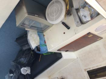

im 3/4 of the way threw the rewire thankfully! iv made most of the templates for the headlining and transferred on to ply so just to cut out then check and cover with white leather :) decoded the big cooker was a no go it takes up too much room so iv opted for a little one ring portable one from b&m, boat cabin is painted and so is the wheelhouse interior,
i have templates for the floor now iv to cut them out of ply and i can carpet it :)

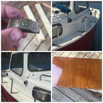

The timber looks great - good job!.

just a quick update, lots and lots of work going on mostly cleaning! some pictures for you guys, the wood in the cabin for the locker under the sink and the porta potty box had all de laminated and was falling apart and looked all faded like the latch in the picture and i have re laminated, not filled the holes but instead i have used the varnish to seal everything, including the holes to give the character of the original wood
hope all is well
Craig

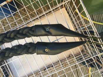

To secure the rope, Normally there with be two "D Rings" in the transom - one either side - the rope has a wire (or polysteel) heart running through it - the ends of the heart are formed into loops. Then cord is used to tie the heart to the D rings - normally using a "Spanish Windlass" or similar technique to tension the rope (Ratchet Straps to help tension when fitting are popular).
The forward end of the rope is fitted using thin cord - this is passed through the rope (i.e. twist the rope open, pass the cord through the rope - ensuring the "get the heart" - then the cord passes through teh two little holes you'll see in the forward edge of teh deck moulding and is tied off. The centre section of teh rope is supported the a length of triangular section hardwood - fastened to the hull under the rope (i.e. the timber is screwed to the hull from within the boat - the screws go through hull mouldling and into the timber...). There should be lots of tips for fitting ropes in the fourm archives. The Navigator, 17PH, 537, 18 Motor Sailer and the Fishing 18 all used the same rope securing method.
I've attached a photo of my old navigator at from the stern 0 you should just be able to make out the D rings and loops in the "heart".
I have seen other boats with ropes fitted that don't have a heart - they use a stainless steel "cup" secured to the transom - it's not as good but works - See "Corsiva Botas".

does anyone know how the rope fender round the boat was originally attached?? specifically at the ends of the rope? i have made the leatherette ends for the rope but wasnt sure of another way to fix them that would look suitable ?
many thanks

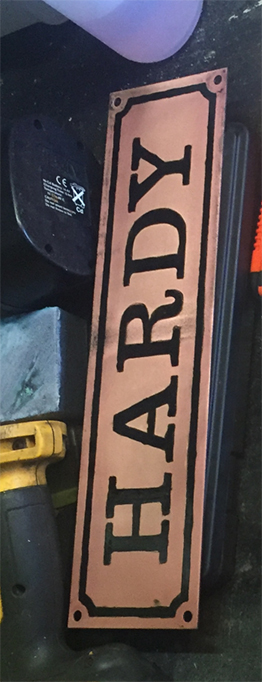

cleaned hardy plates

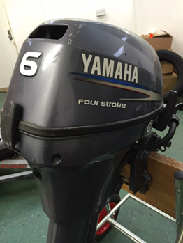

Message 6 of 26
Posted by member craig allan on Sunday 15 May 2016
new engine for her should be here for the end of the month!! :)

new rope fender ends

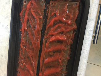

Message 3 of 26
Posted by member craig allan on Saturday 14 May 2016
cleaning hardy plates

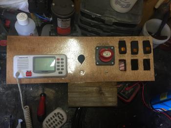

Message 2 of 26

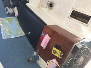

switch panel

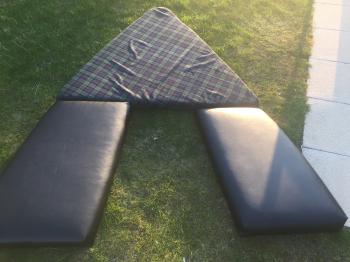

i am a new owner and new to the site so hi all!! :) i got a lovely little hardy navigator motor sailor, she's had her rigging removed and mast gone as well as keels removed too, so just for motoring about with the family,
1: the seating inside was mouldy and green tartan fabric which i have changed to black PVC leatherette,
2: i have the rope fender off and someone had duck taped the ends of the rope and bolted threw the hull so ive removed and made ends for the ropes and in the process of celaning the rope to re attach but will be changing next year for a jute rope as looks far better than the black polypropylene rope thats there,

4: full 12V rewire and new switch board that i have made to be fitted,

7: new carpet in the cabin and hull lining to be replaced also,

9: 6hp yamaha remote outboard ordered to be fitted also need to fit a starter to it for electric start

here are some pictures of the old tartan and new leather,
the rope ends that i have made and my new switch board and vhf pannel so far and a few other bits and bobs :)
