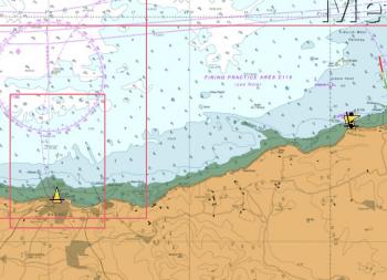

Hi Peter, I must admit I'm having great fun with this. I have managed to pick up the AIS signals using the RTL dongle. Even managed to get it plotted on the OpenCPN chart. I'm on version 4 of a home made antenna at the moment as the range from my home is not that great. I did manage to pick up AIS data from the drilling rig off Hinkley Point which is about 13 miles from Minehead but I was using an antenna on a mast on top of Minehead Lifeboats Boathouse.

I spotted your post some months ago and thought I would give it a try in the winter months. Utilizing an old HP laptop I now have my Garmin GPS 120 talking to the PC via a USB serial converter (£4 from ebay) onto a complete set of UK charts (Unified Charts from visitmyharbour.com £22). Really impressed at the features - not exactly 'plug n play' but it was a fun project for the weekend while waiting for the deck paint to dry. I thought I had seen the last of RS232 when I left college 30 years ago!
Next is to try and get the RTL2832U + R820T DVB-T Stick Tuner Receiver talking to OpenCPN as an AIS receiver (£8 ebay) (apparently it works?????? - still not convinced but I will let you know)
