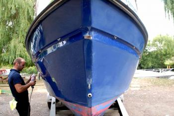

This is a shot of my own Family Pilot when she was out being cleaned and polished, and you can just see the lacing eyes that Simon is referring to. There are actually four on each side of my bow, not three as I previously thought. (Memory going..) Other than lacing up to the U bolts on the stern, these are the only other points to attach the fender to.
Good luck.
HOC Editor

I am Simon Papendick and as a former employee of Hardy Marine, I know the rope fender problem very well. On the Family Pilot's there were three and sometimes four lacing eyes under behind the rope fender. The way the rope fender was tensioned on the boats was with a heavy duty trailer strap with a shackle on both ends. these shackles were fixed to the eyes in the ends of the rope fender and the strap was tensioned to take the lack out of the rope and fit the rope fender into position. At which time the rope fender was fixed to the lacing eyes. When this was done the aft ends were lace to the U bolts on the transom and the strap was released and the rope was tapped into position with a soft mallet.
