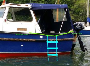

OK latest thought, how's about this...
Pre-rig ladder with heavy line, spliced one end to quickly loop over stern cleat, and other end take turns over midships cleat.
Spreads load over two cleats in strong positions. Emergency ladder easily and quickly rigged from stowage.
Wet human hauled directly into cockpit.

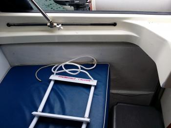

Wondering what others have done...
We do not have a MOB ladder as such, but for emergencies with a crew or someone else in the water, we have a very reasonably priced folding five rung rope ladder as pictured (Force 4; £19.95), that can but hung from a cleat or some-such. We have midships cleats I fitted for aiding mooring (why don't all boats have them?!!) but this is not the easiest location for hauling someone aboard by the side of the wheelhouse on a Family Pilot.
I am considering fitting an additional cleat in the cockpit area, possibly somewhere under the gunwhale through-hull. Has anyone else done this or got thoughts? Needs to be capable of taking the weight of a wet human without stressing the hull of course!
Thanks, Clive

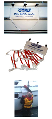

Blimey, I hope that I never find myself in that position, but you just never know and that's the trouble. I think I may have a look at the Markus MOB Safety Ladder - it looks like it might be the right thing for my Family Pilot, and I would be able to reach it whilst in the water ok. Fingers crossed .....
