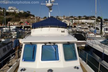

The tension spring in the screen wiper arm of my Pilot 20 has died of rust and I need to remove the arm for repair or replacement.
How is it attached to the motor? I suspect it is a push fit onto mini splines and has corroded tight. The overlapping "brow" of the roof makes access and the use of heat or force difficult to put it mildly. Has any one solved the same problem?
