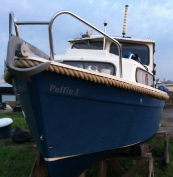

Ive got a photo of the boat prior to launch I will try and upload..
Good luck with fitting wire in rope, I struggled just getting the old one out!

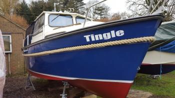

I have just added a picture of the Polyhemp rope fender from Rope Services UK. As stated in a previous post of mine it arrived back to me in 13 days, they gave me polyester cord FOC and were helpful.
It looks good to me and feel it will last as long as a coir rope fender.
I think the fitting to a Navigator is quite different to a Pilot.
As a previous person advised. I tensioned the fender with a Spanish windlass, marked with tape where I need to put the cord through the fender. I then loosened the fender so I can twist the rope to thread the cord through.
On the Navigator from the bow, you have a series of two holes about 15mm apart where after threading to cord though the ropes and around the wire core, I used a locking slip knot secured with a few half hitches. I tied each section of two holes separately. Then towards the centre of the boat there are four pan head bolts (about 15cm apart) above the gunwhale and a washer and nut below it. I think there was once a lacing eye here. As I had to finish the job that day, just secured the cord above washer with a knot then tied each one individually round the wire core of the rope fender.
After this I tensioned the rope fender as before and tied to each securing point with thicker polyester cord.
Although what I have done works, it is time consuming. I am sure there is a quicker way and equally effective way to do it.

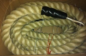

Starting with the rope fender from Rope Services UK, it arrived back today. That is about 13 days (not working days) turnaround. It may vary depending on the amount of business they have.
Obviously I am not as experienced, in Hardy's as many on here. For me I am happy with what I have received back. The total cost including postage was £155.00. They also gave me a couple of metres of 2 and 4mm cord FOC. It cost £7.99 to post the wire to them. They want the rope stripped of which took me about 20 minutes.
The diameter of the three strand construction is 2.25 inches / 57mm. Each strand is 1.0 inch / 25.5mm in diameter.
As you can see the rope is still in the box. I have uploaded one picture for you. I can take more pictures when it is on the boat.
To summarise, with most parts for my boat I would rather pay less, which I have done but in this case I do not think I have lost much if anything at all in quality.
I realise some will want the coir rope.
I hope this helps.
