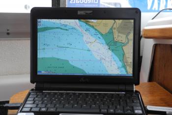

Posted by member CRACKER TOO on Tuesday 17 February 2015
"Radar" for a Bosun.
Charts. http://www.visitmyharbour.com/charts-for-opencpn.aspharts.
Asus netbook ( +5 years old ex ebay.)
http://www.force4.co.uk/department/electronics/ais/transponders/force-4-nauticast-b2-ais-transponder.html#.VOLNHS55bzA
Result attached. Regards. Martin.

Posted by member Cracker Too on Sunday 8 February 2015
Far easier, less power and far less cash required to install a Class B AIS Transponder. Interfaced to a laptop with electronic charts and suitable software.
You'll require an MMSI number on the boat's radio license to program the AIS to transmit your boat's position and details.
I use OpenCPN Software with Raster Charts, On a ASUS Netbook
and a Nauticus B2 AIS Transponder.
Only difference from this set up on my Bosun and the equipment I encountered as a VLS Pilot is the smaller display.
(ABP Humber recommends boat owners consider the use of AIS transponders to enhance safety.)
Regards. Martin.
