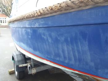

Hi Philip.
A high quality two pack sprayed epoxy job with very carefully matched colour would work wonders (Bring her up like new and last well) I've seen a couple and they look very good - but colour matching to the actual gel coat on the boat is essential, but anything less than a really good spray job would probably end up looking worse (usually far worse) than the original gel coat. Less than a perfect job could hit resale too - some buyers just don't like painted boats and I know a couple of small boat traders who won't buy anything obviously painted. I saw someone recently hand paint the blue band on a Bosun - looked a bit rough - "nuff said".
Wrapping would be a great idea - not easy though, but well worth looking into - it's a great solution if you can make it work at a decent cost.
I know Marie had good results with A Glaze a few years back, it might be worth having a chat with Marie and seeing how it has lasted, I know Marie would be happy to discuss it.
Any Dark gel coat can be an issue, almost all of the hulls I see in Dark blue (from all sorts of manufacturers tend to be chalked now) - some of them are under 10 years old - you'll see a lot of moden boats with them - the finishes don't seem to last all that well, unless it's a really high-quality builder and even then I think it's only a matter of time. The older Seaward 23's and the Channel islands 32's and 22's chalk, and I've seen Swift Trawlers and flashy sportscruisers completely dull.
The last resort - and something only to be carried out once or so, is a wet and dry treatment and then gradual compound and polish - usually using the best quality 3m type kit. This would take the top layers of gel coat off and then re-finish the newly exposed layer under. Clearly, this is a long job - but probably offers the best chance to revive the existing finish.
If it were me, and if really really very bad I'd wear the chalking with pride in the short term and put a little away for a pro wrap, a pro wet and dry job or a proper pro spray, but that's me and as I only have white Hulled Hardys, I'm perhaps not to be Listened to....
Good luck with it!
Oh - on a last throught - have you tried polished with a pigmented blue polish?? Not sure it will help in your case, but might make a differece.

Hi all, I have just taken the boat out of the water and was considering painting the blue hull bit. I have tried so many ways of polishing and waxing and although I get a reasonable looks it never seems to last anymore than a couple of weeks. Has anyone else given up with the polish / wax option? Regards Phil

Gelcoat wise, yes, gentle compound - nothing too aggressive - then, once she's shining again, get a good couple of coats of decent wax (cheap wax just washes away) on her (3m or similar I would have thought), Then, if she's kept ashore, I'd suggest giving her a max every few months - that should keep the chalk at bay.

I think that if you try machine polishing with a number 3 cutting compond and then finish with a hand polish using a number 10 cutting compond you will get rid of any oxidisation marks without resorting to the wet and dry method , which in my opinion would be a very extreme measure indeed.
This is how I have always polished my current and previous Hardys, and then finishesd them off with a couple of good coats of hard wax, (old fashioned simoniz ) or even a proffessional glaze wax as used in the auto trade . Works a treat , and if done properly will bring back and maintain a 'as new'finish.

Any rubbing compund is ideal for removing it. I have also read that you can use very fine wet and dry (used wet) to get rid of this in particularly bad cases.
My own thought is to use the least drastic technique possible and I always get excellent results with rubbing compound.

I've just done the entire hull of our Pilot 20, using an electric mop polisher that I got from ASAP for £20 - best thing I ever bought. It effortlessly removed the oxidisation using cutting compound and then applied a good quality wax polish and now Daisy looks very good.
