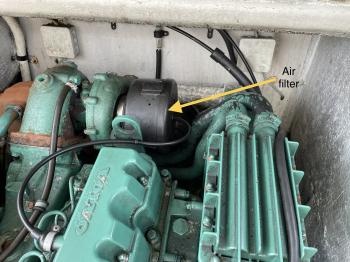

Location of filter

Charlie sorry my response is so late.
Recently I encountered exactly the same problem with my Hardy Fishing 24 with the Volvo AD41. After very expensively overhauling turbo, fuel pump and injectors as well as replacing fuel filters etc finally tracked the problem down to completely blocked (with oil residues?) air filter !! Perhaps if we had only checked this thoroughly to begin with might have saved a lot of expense.
Hope you have now sorted ?
Morgan
