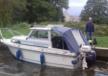

Hi, I have a seawings 194 and would like to put a hot water heater for washing and a make-shift shower. Our canal trips so far have consisted of ringing around hotels and pubs in the afternoon to try to find somewhere to stay. So far we have not slept on board but hope to spend increasing amounts of time afloat so would like to do so in future. I have put in a caravan type cassette loo and a propax heater.
The only way I can see to put in a heater is a Morco type one on the toilet compartment wall in the cabin with a horizontal flue out the side, or should I have a balanced flue gas heater?
I assume I cannot use a Truma type in the cockpit under a seat?
