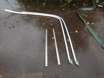

Posted by member Russell George on Tuesday 18 August 2020
Many thanks all and to Richard and his wife I now have both a frame and cover

Posted by member Richard Moynan on Monday 17 August 2020
Russ
I have a spare two part hoop and two stainless steel sliders off a Hardy Fisher 20. We have a cover at the back of the wheel house and will never need our back cover frame. The only part missing is the piece from the roof to the frame which will be shorter on a Pilot and could very easily me made to suit your requirements in matching diameter aluminium tube. Please get in contact on 07836 772284 or rmoynan@aol.com. I attach photos Items near Exeter Devon.
Regards Richard Moynan
