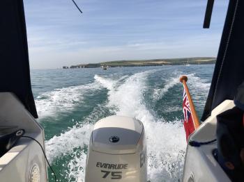

This is the prop size fitted

Just had new engine fitted 75hp Etech and also fitted lectro trim tabs. This has made a massive difference the trim tabs work better than I could have expected. Can now plane at about 11 knts cruise at 17 knts and max out at 24 knts.
