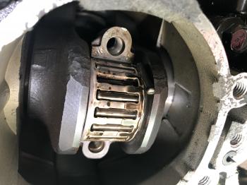

Hi Jim.
Sadly - all the moving parts - Big ends, main bearings, Cylinder Bores etc - lots on the US forums. You might be lucky, but would think bets to expect damage.

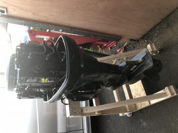

Not had a chance to test the replacement engine properly as had a failure. Discovered oil pump was blocked so engine had run without correct oil being added. Now developed a nasty knocking sound. Engine has now been removed for surgery in the garage on my home built stand. Any ideas where to start looking for problems.
