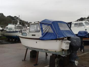

Posted by member Simon Kidd on Monday 28 May 2018
Hi Andy.
Please see attached a picture of my beloved and missed old Navigator with the Hardy Locker mounted on the transom to Port. The lid was missing on Hauley - a canvas cover was made instead, the original was a hinged affair - GRP I suspect (Simon P would likely be able to confirm).
Simon K
(HOC Tec Sec).

Posted by member Andy Dore on Thursday 24 May 2018
Hi Simon,
Thanks for your response, did the locker fit within the outboard motor well or was it attached to the back of the transom on the outside of the boat,
I'm sure I can find or make something similar once I know what it looks like, does anyone have a photo of an original one that they could send to me please,
Thanks all
Andy
Message 2 of 12
Posted by member Simon Papendick on Wednesday 23 May 2018
Hi Andy
You are missing the outboard locker which we made at Hardy Marine. As I worked at Hardy Marine during that time If I had the measurement I could possibly be able to make one for you out of GRP. As this is what the original lockers were made from.
Former hardy marine employee
