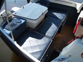

Posted by member HOC Editor on Monday 15 May 2017
Hi Kenny
I will try and drop this image in of the set up on my boat and the seating across the aft lockers in front of the engine well.

Hi Clive,
I have a similar arrangement to you on my Pilot and without realising it, I made an alteration to the seating in my wheelhouse which provides cover for my fuel tank when it is very hot and sunny. I attached two wooden supports, one on the side of each of the rear lockers, then fashioned a nice piece of marine ply to fit into the space to the front of the well and resting on the battens which I varnished and had a matching cushion made to fit on top. This makes a really nice long bunk type seat in front of the engine well, and joins the cushions on top of the lockers. The engine well is then in shade and reasonably covered from the gaze of casual burglars as well. We've had a spate of petrol thefts at my marina. I usually remove my tank from my boat when I'm not using it.
To make things comfortable, I placed bolster cushions on each of the locker seats, and one in the middle, pressed under the lip of the upper part of the well making a nice soft back support.
I added a slatted timber section which fits in to the bottom of engine well, on which the tank sits, slightly raised, and has the prerequisite strap attachments (two either side) in theory to secure the tank, to keep the Boat Safety Examiner happy. I've found that the tank fits snugly in there anyway.
The additional space beneath this slatted shelf is deep enough to house the hose of my manual bilge pump, the handle of which is attached to the outer side of the well. I will try and take a picture, as I'm not too sure this explanation is clear enough. However, I like the idea of the fire blankets.
