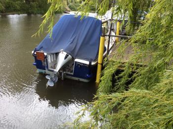

My answer to mooring of X off,
I have fitted two extra scaffold poles on my mooring about 6" further out into the river, I have then slipped on plastic gas type pipes about 6" dia. Over the upright scaffold poles, the boat lays up against the gas pipe the stern being held by a rope around the gas pipe which is then fastened back on the cleat, the boat can ride up and down on the smooth plastic pipe and springs are not necessary the bow is still on the original bow line which runs forward to the bank. There is a little give /flexing in the plastic pipe which is an asset. As this is an experiment on our part of the river I will let you know what happens.

Hi David and Tony,thanks for your comments, I think being a tidal berth having a rise and fall of about 5 feet which is not a lot but enough to think that mooring wands and chain on the outside of the boat wouldn't help unless the wands can somehow adjust to the tidal variations.
The serving of a softer rope around the mooring uprights would help temporarily but probably wouldn't last long..
I am going to try putting yellow pipe about 6" dia over the scaffold poles the pipe being a hard plastic and 2 metres long and see what happens, will keep you posted.

My Regatta is on a bank mooring where the boat rides on a scaffold pole mooring faced with two uprights faced with rubber rendering about 10 ft. Apart. The constant chafing on these rubber fenders is hammering the the rope that is fixed around the hull.
The question is is there any way the boat could be moored so the rope fender is held away from the mooring by about a foot or so ?
Putting poles out in the river would be a no,no. It would have to be from the mooring only. Please don't suggest fenders as they seem to rub of paint or gel coat from the hull.
