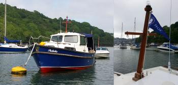

And finally, to complete the story...
The previously materialised mahogony plank has now had part of itself made into the new mast for Adele, and is now raised upon the wheelhouse, complete with HOC burgee, LED nav/anchor light, wire up the middle of the mast, and can be lowered for bridges, should the need arise, though we have no bridges in Fowey harbour!
Personally, I prefer the mast on the top of the wheelhouse roof to give greater height for the nav light, looks, and I don't have an artificial tree in front of the windscreen to have to look through!
Height is 860mm, routed internal channel for the cable, and basic plans are available if anyone is interested. I will endeavour to post more photos of making the mast on my website in due course, and will send Marie an article for the magazine should anyone be interested in more details.

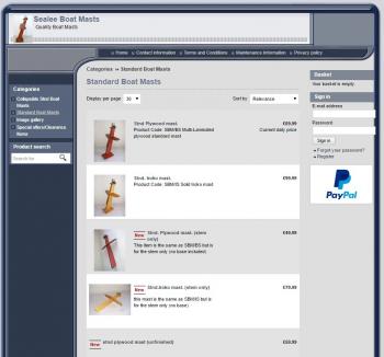

Research goes on... the supposed piece of iroko I thought I had seems to have evaporated on some other job, but a suitable piece of unused 25mm mahogany plank has materialised in its place, so I shall be proceeding to my own design... I'm looking at 850mm tall inc. fixtures, without light, and a cross piece of around 510mm about 2/3 up. Angle of rake 15deg. I will post better measurements when done for anyone interested in doing same.
Alternatively, should this be a better choice for others, I have also found a new source online, which seems to be the best by far of available online offerings... at Sealee Boat Masts, very reasonable prices £49 to £130 depending on whether you want collapsible, fixed or stem only, in ply, iroko or mahogany. The link is www.sealeeboatmasts.co.uk for full details. There are also some useful looking seconds from Sealee currently on auction on eBay.

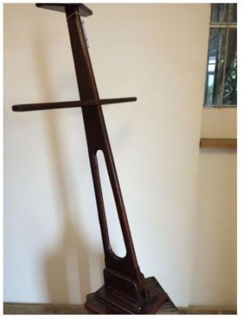

Posted by member Clive ffitch on Thursday 17 November 2016
Finally had a reply from Sheridan Marine - the dark mahogany Freeman 22 mast in Message 3 retails at a lovely £183.60 inc VAT plus postage, plus an additional £53.71 for the stainless mast base if required, making a glorious fairly round £250 or so.

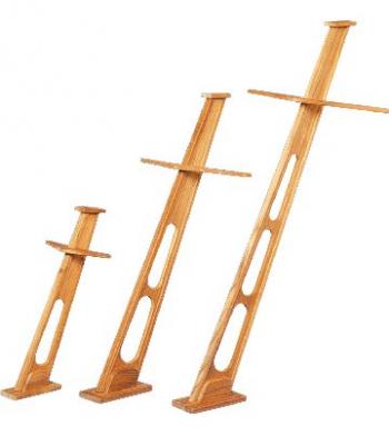

Posted by member Kenny Clark on Sunday 6 November 2016
Clive, Ouch very expensive. Prefer your version, much simpler design and looks like it would be more in keeping with Hardy lines.

Posted by member Clive Ffitch on Sunday 6 November 2016
Hi Kenny,
Thanks for that, price appears to be around £174 inc. VAT though not sure which of three sizes as yet, for the teak mast pic in your message.
I have also found another short mast available from Sheridan Marine as attached photo, referred to as fitting the Freeman 22 (this one being mahogony, height 0.89m). I am chasing price of this item.
Third option so far seems to be check out what odd bits of mahogony or iroko that I may still have in the garage and sharpen my tools!
Will keep everyone posted (sorry, pun a bit rough that one!) and still interested to hear of what others may have done.
