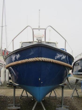

Posted by member Kenny Clark on Monday 10 October 2016
Hi Dave, Just seen your post. I have propped Family Pilot 20 with legs, see photos.
I have also used sleeper blocks fore/aft under keel, with logs wedged at ground level. A bit more time, work to secure.
Always have boat level, as it would be on water.
Good luck.

Posted by member Dave Brook on Wednesday 14 September 2016
I'm a new Navigator owner in Plymouth and will be craning the boat out this autumn as I don't have a trailer. I'd planned on sitting it on some lengths of railway sleeper and putting a couple of acro props to support it once the crane's dropped it down. I'll then put more wooden props and chocks around it once the lifting cradles have been removed to make it secure.
Where is the best place on the hull to support it on the acros? I think the size 0 acro should be ok (1m - 1.8m).
Is it best to chock it slightly stern down, level or bow down - or doesn't it matter ?
Does anyone have any photos of a Navigator (or similar) safely chocked in the yard ?
Thanks for any advice and I'm sure I'll be posting more questions......
