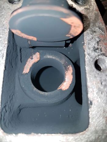

Our turbo was sent away for reconditioning as the gate valve was freed up but the turbo wasn't spinning freely and it all looked very coked up.
It was returned in a few days, refitted and we took her out to find that we now have a much more confident boat - still a slight, but I think normal lag, nothing like the ages it was taking before. And once the turbo has kicked in, the throttle and speeds are very responsive making us feel in control and giving us much more comfort in rough seas.

Thanks for the hints on cause. Seems that following another sea test with a Yanmar specialist mechanic, it could be the turbo waste gate / valve. On a quick inspection he thinks it could be stuck open. This would mean that there is a long delay before sufficient pressure builds up in the system to initiate the turbo.
Looking around on line for that specifically, has shown similar incidences that share seemingly common symptoms. We will hopefully see on Tuesday when he removes the component to try cleaning it and freeing it's movement. Fingers crossed.
