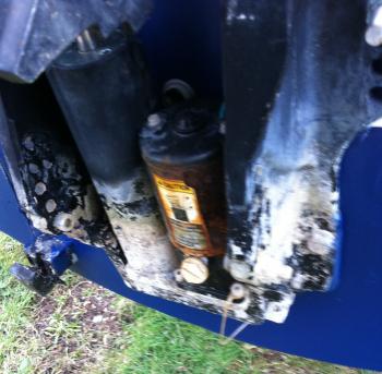

Posted by member Clive Ffitch on Thursday 14 April 2016
Hi Rob,
The tilt mechanism on your Mariner looks just like ours did. We have a Mariner 75 on Adele and after a good clean up and scrape off of all the offending dried out marine growths, I masked off all areas that I wanted to protect with masking tape and plastic bags, and used Mercury/Mariner Quicksilver "Phantom Black" enamel spray paint - high gloss and quick drying, and intended specifically for outboard legs and stern-drives. I did not use any primer, and after doing this for two seasons (not so much treatment needed the second time around) the results still seem pretty good. We also spray with Quicksilver "Corrosion Guard" before launching out to the mooring. It is also recommended to spray Corrosion Guard periodically through the season as well which we haven't as yet done.
We will be using the same method again this year, with perhaps periodic additional corrosion guarding.
Some people seem to prime and antifoul with special outboard leg antifouling paint, but we have not gone down that route yet - our outboard is left tilted up when on the mooring. However with our trim tab rams, I primed these with antifouling primer, and then antifouled with the normal stuff - in our case Hempel Tiger Extra.
On the subject of tilt mechanisms, ours turned out to have an internally corroded tilt tube that caused eventual near seizure, without a little human assistance to raise it - most likely due to poor lubrication in previous years by previous engine owner, and put initially down to a poor battery. Keeping the tilt tube well greased is just as important as looking after the tilt ram itself. However horrible the state of the electric tilt and ram down there in the water seems to be though, they do seem to be pretty well sealed (big touch wood!), providing they are kept clean, painted and protected, and don't become home to too many baby mussels!
Good luck whichever method you choose!
Posted by member Rob on Wednesday 13 April 2016
Hello again.
I have put a picture of my tilt mechanism after some rust treatment.
Any help would be appreciated.

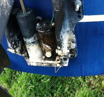

Hello all
When my boat was lifted out of the water I noticed the tilt mechanism was very rusty. I have a picture on this post prior to rust treatment and one on my next post after treatment.
I am just asking if someone knows the best primer and best paint to use after my rust treatment.
The engine is a Mariner 50hp, four stroke, bigfoot.
Rob
