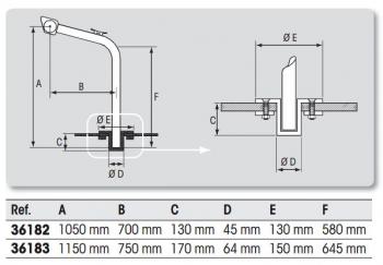

Corner connector, to form 90deg angle. Still looking for fitting that would give 135deg angle which would look more like the typical Davit shape.

Will need to use the following to form pair of davits:
1) Adjustable bracket 2no. - for main fixing of tube to horizontal/vertical face of transom. (As photo)
2) Corner connector 2no. - to join tube to form inverted 'L' shape davit.
3) End socket 2no. - to hang shackles.
4) Aluminium tube - four sections cut to required length and polished.
5) Brace 2no. - to secure inverted 'L' davit shape. Might be S/S threaded rod or similar that takes the load of dinghy.
6) Cleate 2no.- to tie off.
7) Set of pulley blocks and line.
Will let you know if I have a go at this option.

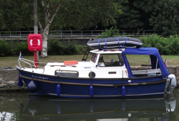

Hi Kenny,
The picture looks a bit compressed on here, so both my dinghy and Family Pilot as not that squashed !! :-)
Yes, you can get two in her - just - it is supposed to be a 2+1 so we were reckoning on two plus dogs...
What I do is set her so the transom is forward and the tubes sit either side of my mast. The weight, such as it is, is supported mainly by the coach roof and so does not press too much on the canopy. I must admit that when I do get around to radar and reflector, I will have to think carefully. I could not see a way to have davits, and having anything at all on the foredeck cuts down visibility. In some situations, I can tow her, but I prefer this way when on tidal. I know that some members keep their dinghy partially inflated and on top of their anchor well, but I thought I would try this, and it seems to work ok.
