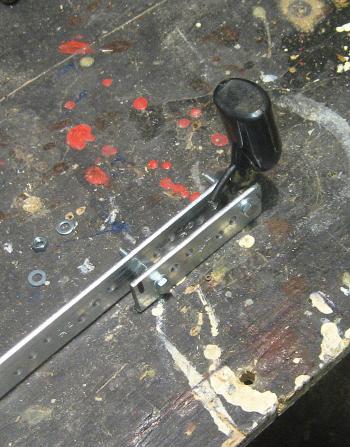

Posted by member Mike Insall on Sunday 27 December 2015
My Fish finder / depth finder went US recently, and although it was out of warranty I decided to take it back to Force 4 in Burlesdon to see it it could perhaps be fixed.
They said they would send it off the Lowrance in Romsey (not far away) and see what they thought!
I said that if it would cost more than about £50 it would be better to buy a new one!
Anyway, after about ten days I had a phone call to say that they had received a new instrument and it was FREE!
It was also a bit of an upgrade!
A nice gesture by Lowrance, and very good service by Force 4!
I also note the following that may be of interest.
When I fitted the first fishfinder, it seemed a bit daft that the bracket had to be fitted below the waterline.
For obvious reasons this is a bit of a pain, so I contacted Lowrance to see if they perhaps made an extension, but they didn't!
So, I thought I would try to make one myself, which I did quite quickly.
However, with the coming of the new one I though I would try to improve the extension for two reasons.
Firstly I wanted to avoid having the bracket anywhere near the waterline, and I also wanted to make fittine easier and to allow me to bring the transponder out of the water!
I've made one that may look a bit heavy duty, but it's only cost me about £6 using items from B&Q! and it's pretty strong.
I attach a photo of the beast just in case anyone is of the same mind! I can only attache one photo, but it's about 800mm long allowing for it to be some 100mm in the water but still easy to fix without having to lean over too far! The bolts are not the actual ones I'll use, which will be shorter and of course stainless steelfrom Force 4!
I note it would be possible to make a neater job of it, but I ain't no high class fabricator!!
