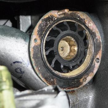

Posted by member Peter Cox on Thursday 18 June 2015
The boatyard has now replaced the brass screws (sorry - not bolts, as I originally wrote) with stainless steel ones. Both pumps had to be removed from the engines; fortunately this gave access to the 'back' of the screw holes so that the remaining stubs of the screws could be unscrewed, after a little modification, from there, without drilling and tapping. I took the opportunity to have the impellers replaced. The cover plates were a bit worn, so were reversed. The boatyard said that the other boat, not a Hardy but the same engines, had one of the cover plates held on by only one remaining screw; disaster narrowly averted!

Posted by member John on Tuesday 9 June 2015
The same problem Peter. I guess a bit of salt water gets in and causes corrosion as the engine gets older. Some had a bit of thread left so was able to remove these with WD40 and patience, although not easy to get at! One had to be drilled out and retapped, done in situ but would not be possible with some of them.
They seem to be M4 brass (Yanmar Product Code WPS-M4) and cost £1 or so each. These are actually Johnston pumps.
I was thinking of replacing these with phosphor bronze studs and then using nuts to fix the cover, and possibly a little waterproof grease on the threads to minimise corrosion.
Best of luck

Posted by member Peter Cox on Monday 8 June 2015
On my twin 6LPA-DTP engines, several of the bolts securing the impeller cover plates have simply corroded away or the heads have fallen off, so that the remaining studs will have to be drilled out. Not a cheap job, as the entire pumps will have to be removed. My marina workshop says that this is the second of these jobs they have had to do on this type of engine in the last few weeks. Why does Yanmar do this? If you remove the cover plate on any Yanmar, it might be worth renewing the bolts as routine.
